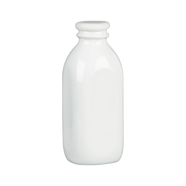

Een meer strakke witte fles (wel scherp weergegeven):
Zie flessen op volle grootte:
http://www.purpleflame.co.uk/wp-content ... 100ml1.jpg" onclick="window.open(this.href);return false;
http://twoshepherdsvineyards.com/wp-con ... le_IMG.jpg" onclick="window.open(this.href);return false;
De donkere rand, met name links in de fles:
Bron: http://packagingoptionsdirect.com/4-oz- ... und-bottle" onclick="window.open(this.href);return false;
